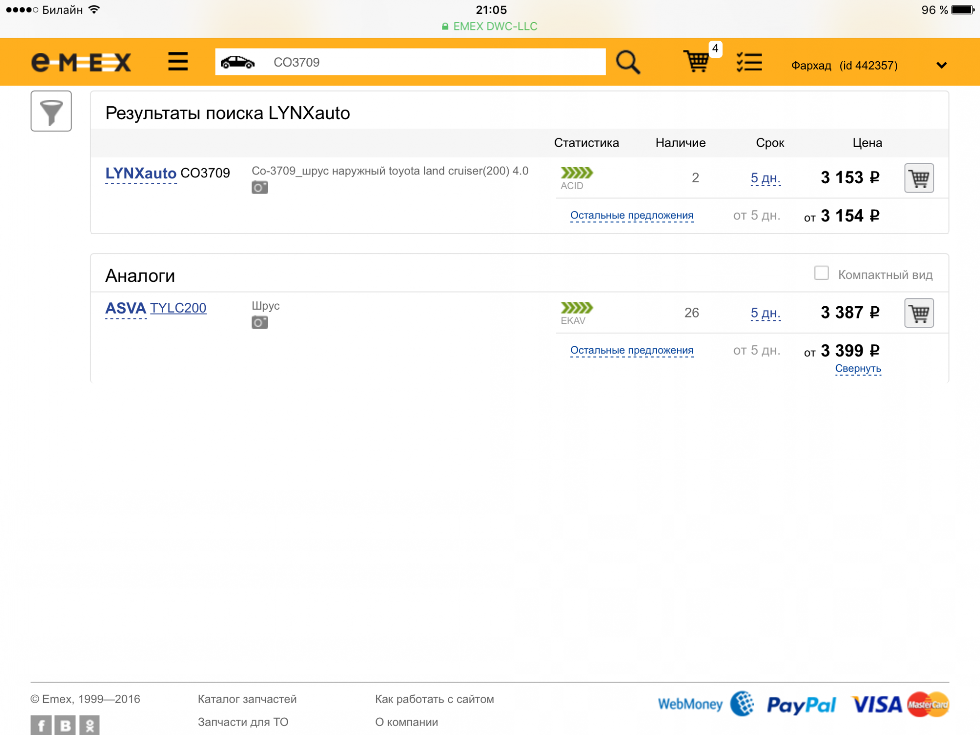

Игорь Каменск Posted January 26, 2016 Share Posted January 26, 2016 Привод в сборе оригенал 40+ рублей стоитТе что выложил с 200 и 570 нам подходят? Link to comment Share on other sites More sharing options...

Prospect Ямал Posted January 27, 2016 Author Prospect Share Posted January 27, 2016 Те что выложил с 200 и 570 нам подходят?Да. Встала как родная Link to comment Share on other sites More sharing options...
Prospect OLEGHM Posted January 28, 2016 Prospect Share Posted January 28, 2016 Да. Встала как роднаяОт 200? или 570? Link to comment Share on other sites More sharing options...
Prospect Ямал Posted January 28, 2016 Author Prospect Share Posted January 28, 2016 От 200? или 570?Я поставил от 570 Link to comment Share on other sites More sharing options...
